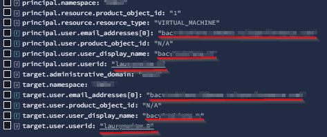

Hello and thank you for your response!
As an example you can check the below event which was included in the results of a very simple query (user = "xyz")
However, the user I searched for appeared as an extended field correlated to a log that was unrelated to them.
This significantly complicates investigations, as I have to manually verify the actual relevance of each result. Ideally, I'd like to exclude this behavior—where SIEM automatically includes extended fields—so that searches return only directly relevant results.

So far, I haven’t found any event type, log source, platform, or vendor filter that effectively prevents these extended results from appearing. Do you know of any specific methods or settings that could help refine searches to avoid this issue?
