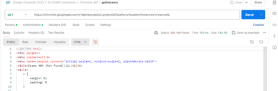

Hi dear all,
Thank you so much.
I tried the API endpoint(POST https://chronicle.googleapis.com/v1alpha/projects/{project}/locations/{location}/instances/{instance...) with GCP Project ID and Customer ID obtained from SecOps SETTING S Profile; as I don't know the location, so I use the default value "us", but API returns 404 Not Found.
I am not sure if I inputed the wrong location or it is an IAM issue. Appreciate your kind comments.
One gotcha is that the API endpoint for the US is
 Here is some more of my script
Thanks Brian. So I have to prefix "us-" before POST https://chronicle.googleapis.com/v1alpha/{instance}/legacy:legacyUpdateAlert?  As in API doc(https://cloud.google.com/chronicle/docs/reference/rest/v1alpha/projects.locations.instances.legacy/l...), it doesn't mention that I should prefix region ahead of base url.
