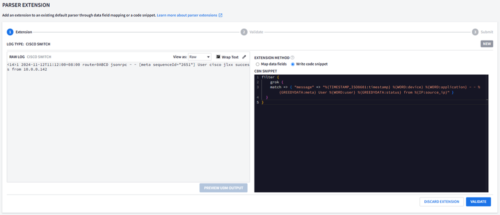

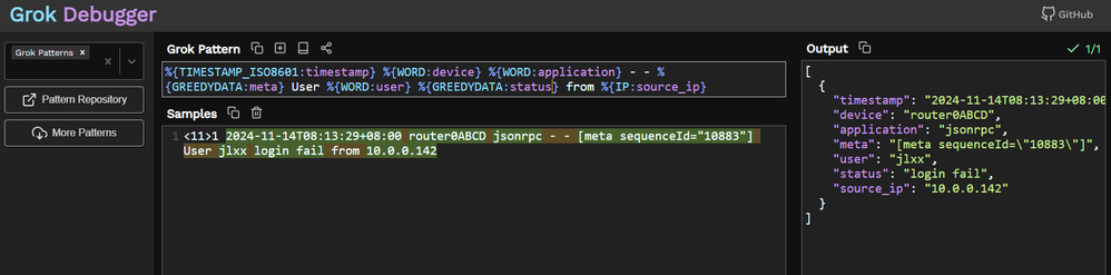

I managed to build a Grok filter that extracts all the values that I need for that specific application (jsonrpc):
%{TIMESTAMP_ISO8601:timestamp} %{WORD:device} %{WORD:application} - - %{GREEDYDATA:meta} User %{WORD:user} %{GREEDYDATA:status} from %{IP:source_ip}
This is the output of the Grok Debugger:
Then, I tried to create a CBN snippet, using that Grok filter:
filter {
grok {
match => { "message" => "%{TIMESTAMP_ISO8601:timestamp} %{WORD:device} %{WORD:application} - - %{GREEDYDATA:meta} User %{WORD:user} %{GREEDYDATA:status} from %{IP:source_ip}" }
This is what it looks like:
But something in missing from my code, as during the validation, it tries to run on the last message received from the switch (not jsonrpc) and since the syntax is different, it fails:
I tried to review the online guide for this, but didn't understand what to put in the code to dedicate this Grok filter to the specific jsonrpc application.
What am I doing wrong? I feel that I'm close, but I don't know how to proceed.
Thanks for your help
