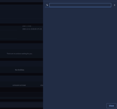

using below: but it creates empty events.
Event --> view more

I think maybe the Events are in the wrong structure, looking at Swagger
