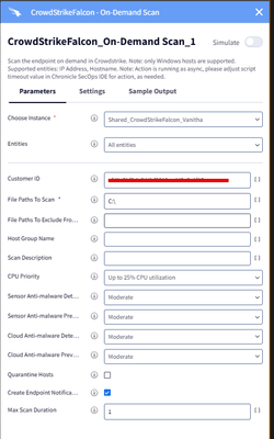

now im getting this issue -
Failed to execute action. Error: An error occurred: pause_duration (2) must be less than or equal to the max_duration (1)
we option for max duration scan but pause duration field is not there in the action parameters

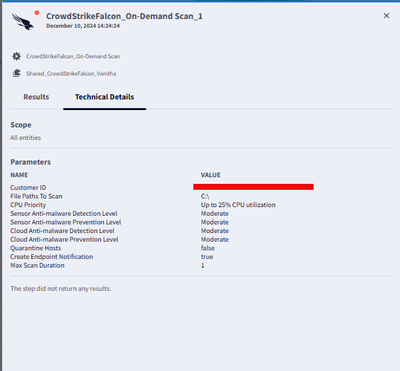

Hi @vanitharaj1208 could you please show technical details or send a parameters you are using to run the action?
Here you go!!
Please open a support ticket with it. We are not using "pause_duration" in our API request, and it seems we need to add it according to this message.
Also, you can try to set Max Scan Duration to higher or equal value to 2 and it should work.
