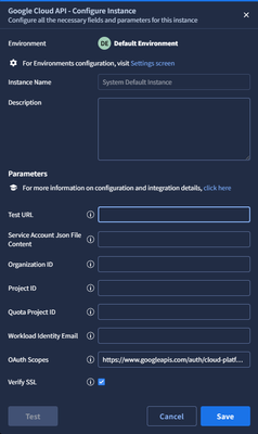

Google Cloud API integration configuration that has Workload Identity AuthenticationGoogle Cloud API integration configuration that has Workload Identity Authentication
All of Google Cloud integrations will feature 2 types of authentications:
  • Workload Identity
  • Service Account Key
Inside the configuration you will see a parameter called “Workload Identity Email”, which is standartised across Marketplace. This parameter is responsible for the Workload Identity authentication.
In order to authenticate, you just need to perform 3 steps:
  • Create a principal that is going to be used for impersonation
  • Grant the python pod SA “Service Account Token Creator” Role
  • Use the created principal inside integration configuration

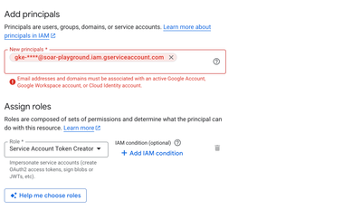

Now that you know the python pod SA, you need to grant it the “Service Account Token Creator” Role in the project of your Google Cloud org.

Hi @ylandovskyy , Thanks for the detailed solution. I am ending up with the same error for the impersonation. What is this gke-****@soar-playground.iam.gserviceaccount.com? and where can I find this python pod SA. It doesn't exist in my org or project in GCP.
Hey @sangaviv ,
The gke-****@soar-playground.iam.gserviceaccount.com is the python pod SA. So, it means that you need to add Role to it within your Google Cloud org. Like in the screenshot below. After that you will be able to perform impersonation with the SA that you want to use inside your integrations.
Let me know, if it makes sense
Yes, that worked. Thanks a lot Yuriy!
