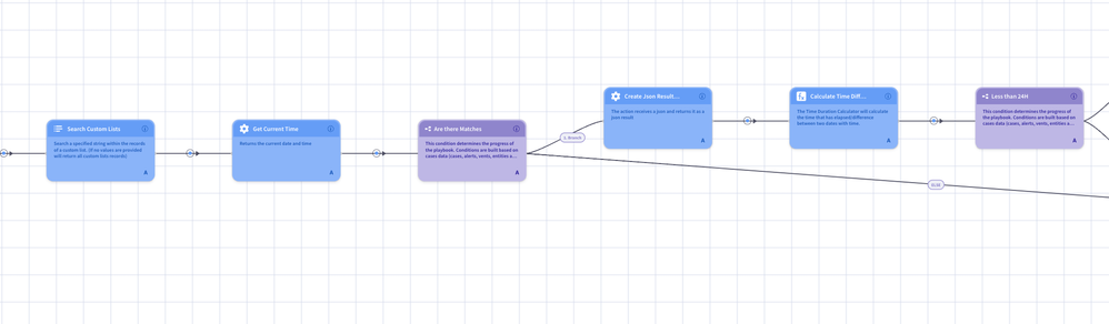

You can use "IOC-DATA" as a category. This is the flow you can use:
  1. Use the search "Search Custom Lists" under the "Lists" powerups. This allows you to search for a specific string in a List Category. If you are doing this for one single IOC, you can use the IOC as the string to search. If you are using more than one IOC at a time, you can leave the string blank to retrieve all records for the category and then filter in a different step.
  2. Get current time ("Get Current Time" tools powerup)
  3. Check if you have matching results. If not, execute your API Call and save the result as a record to your list. The structure can be: {"ioc":"{IOC Value}", "date":"{CurrentDate Result}", "data":"{API Response}"}.
  4. If there are matches: use the buffer action to create a JSON result from the entry in the custom list - this will let you work with the different fields.
  5. Compare the time in the match vs the current time: there are different ways of doing this, depending on the time format. If an epoch timestamp, a simple arithmetic operation would work; if working with datetime formats, you can use the "Time duration Calculation" to get the difference between both times.

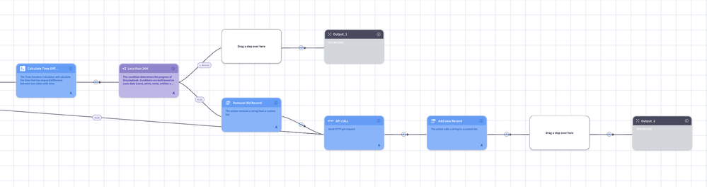

  6. If the difference is more than 24 hours: delete existing record from the list, execute your API Call and save the result to your list and output the result of the API to the block. If not, use the match as output to the block.
This is a general flow you could try. Depending on specifics like multiple IOCs, consistency of the data, integrations being used, etc., you might need to make some changes or add some additional steps.
