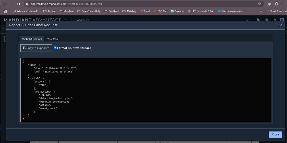

Hi @TomAtGoogle thank you, I was able to use the API with a browser extension like API Tester (I added header Authorization: Bearer <api key> for authentication).

I usually go into Report Builder and just create a data table to show me what fields are available and/or what fields I want.  Check out this screenshot:
The request data is the what I need to get those fields back.
