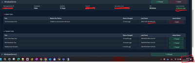

Hi @TomAtGoogle , more details about my previous question.
I experience some times a strange stituation like the following:
I get an alert from the Director that one or more actors are not communicating with it.
As soon as I check, actor shows Last Comm "A minute ago". See for example the screenshot.
Last check of the communication test is 06:18UTC. I took the screenshot at 8:19 CEST (6:19 UTC), qjust a minute after the communication test. The last comms shows "A minute ago". The message passed on by the Director is ambiguous to say the least.
So, I'm interested in understanding if the test you suggest with your script is more reliable than the one executed by the Director.
Thank you,
Paolo
Hi Paolo,
My script simply forces a refresh between the Actor and the Director.  There are times when an actor doesn't check in as scheduled or the Director doesn't register the check in.  This "ping" just forces a sync between the two of them.
That being said, operational status checks only happen once a day unless the default configuration is changed.  If it fails at 6:18 am, it will stay failed until the next day even if the actor comes back online.
