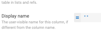

  1. Eliminate the heading by placing a space in the โ€œDisplay nameโ€ spot
  2. Refer to @Gerald_Kariukiโ€™s โ€œText font trickโ€ to hard-encode a different appearance to your heading text:
    Text font trick
  3. Put a line change into your Google sheet that you can use as your โ€œreturnโ€
  4. Put it all together in a concatenate() expression:
    concatenate(โ€œ๐•Š๐•–๐•”๐• ๐•Ÿ๐•• ๐•™๐•–๐•’๐••๐•š๐•Ÿ๐•˜โ€,[Line change],[Second heading])

Unfortunately, this is not going to work as solution for me. For instance, when you change the display name to blank, i.e. " ", then we will lose the column name from other view, especially the field name in table view is also left blank.
I just simply want to have optional setting for detail view only to set the size of field name, large, small etc.
Sure. I understand that itโ€™s a problematic solution. In your case, if you really wanted to do this, I think that it would be possible if you made extra virtual columns just for the purpose โ€“ but that would be a lot of extra work. It will be much better if AppSheet can provide a permanent fix.
I do this using SWITCH() and CONTEXT() in the Display Name expression. Then I can show different labels based on View Type (table, detail, etc) or on specific Views (name of the view where you donโ€™t want to show the column name). SWITCH works well because you can list lots of different scenarios.
SWITCH(
CONTEXT(โ€œViewTypeโ€),
โ€œtableโ€,โ€œtables are dopeโ€,
โ€œdetailโ€," ",
โ€œboring olโ€™ column nameโ€
