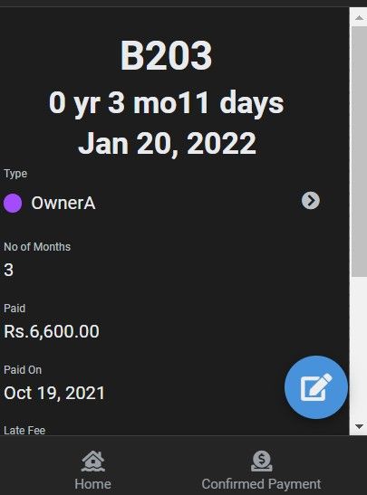

I used that formula to calculate due date but it is having error in calculating days
IFS(
  ISBLANK([Due Date]),
    "Unscheduled",
  (TODAY() > [Due Date]),
    "Overdue!",
  (TODAY() = [Due Date]),
    "Due today",
  (TODAY() = ([Due Date] - 1)),
    "Due tomorrow",
  TRUE,
    (FLOOR(HOUR([Due Date]-today())/365/24)&" yr "&
FLOOR(MOD((HOUR([Due Date]-today())/24),365)*12/365) & " mo" &
FLOOR(HOUR(EOMONTH([Due Date],0)-[Due Date])/24)
  ) & " days"
for example for today on 19th oct 21 and due date 20 jan 22 it is calculating 3 month 11 days instead of 3 months 1 day, I think i made some error in last step can anybody figure it out and help ! thanks in advance.

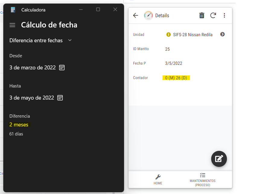

Hi Steve, I still don't have the correct result. I attached an image for comparison, please...
IFS(
ISNOTBLANK([No Orden]),
"Realizado",
TRUE,
IFS(
ISBLANK([Fecha Prog.]),
"Falta Fecha de Mantenimiento",
(TODAY() > [Fecha Prog.]),
"ยกVencido!",
(TODAY() = [Fecha Prog.]),
"ยกVence Hoy!",
(TODAY() = ([Fecha Prog.] - 1)),
"ยกVence Maรฑana!",
TRUE,
CONCATENATE(
FLOOR(MOD((HOUR([Fecha Prog.]-today())/24),365)*12/365)
& " (M) " &
FLOOR(HOUR(EOMONTH([Fecha Prog.],0)-[Fecha Prog.])/24))
& " (D) "
@Steve wrote:
Huh?
@Steve wrote:
Huh?
