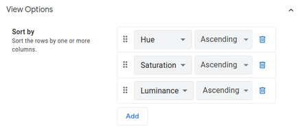

Note that I haven't found the perfect way to sort colors yet. I checked this article for this:
https://www.alanzuccini.com/2015/09/30/colour-sorting/

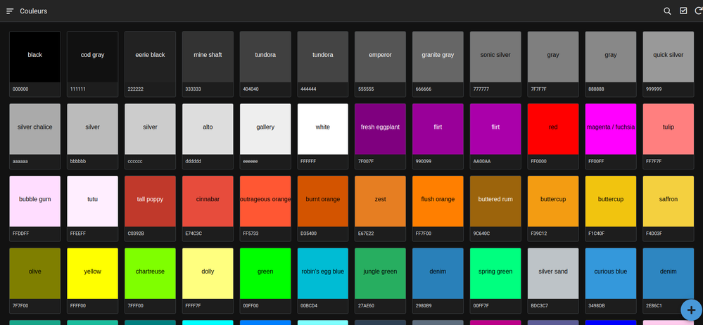

I did this sorting:
And I get this with some random colors:
Capture dโ€™รฉcran du 2023-05-11 09-56-51.pngCapture dโ€™รฉcran du 2023-05-11 09-57-36.png
Not too bad, but far from perfect. I would like to get something like this:
Or like this :
