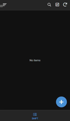

I have checked both the cases i.e. ADD and EDIT please see the GIF below.
ADD and EDIT ROWADD and EDIT ROW
[DATE] always updates and takes the live value from Form-View for both ADD and EDIT
[_THISROW].[DATE] as well as [_THISROW_BEFORE].[DATE] is behaving the same way and does not update unless the Form is saved for both ADD and EDIT
Hope this is what you were referring to

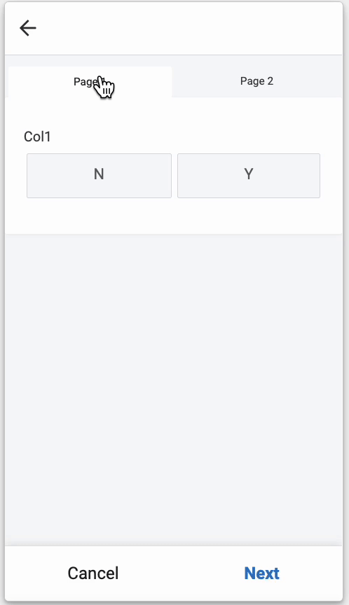

Hi @Koichi_Tsuji I have tested it now in the New Desktop UX. There is some change seen here. Posting the screen recording of the same below
Screen Recording

I find that if [_THISROW] is used in SHOW? expression it's calcurated not only when saved but also the other page is selected. So [_THISROW] probaly don't consider value from G sheet in SHOW? expression.
