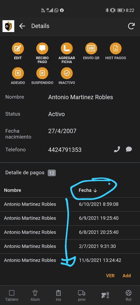

I need to sort a related column by date in descending order.

I have tried to organize this list in alphabetical order and I have not succeeded, so I go to you to guide me to achieve it.
