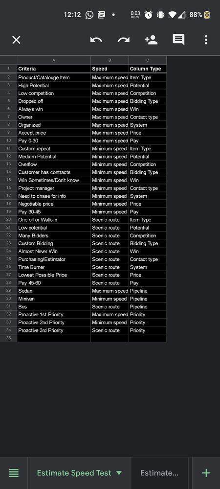

I need to do like column only because I have few criterias and each column have 3 options that is selected from the table like you mentioned above. But for my requirement I need almost 11 column and each column Is different criteria like priority, price, item type etcโ€ฆ but everything has a table that is listed and selected using select function.
For you reference. This is the table Iโ€™m using.
This is a normalized table. Why canโ€™t you operate on this table as is? Where is it that you are using the โ€œlikeโ€ columns as suggested in this post above?
Here.
This table also looks normalized. Iโ€™m confused. Which columns relate to your original question shown above?

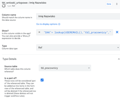

I have a problem with [_thisrow-1] function....
table tbl_pracownicy is a table with employees
table tbl_wnioski_urlopowe is a tablke with all Vacation requests of employees
I'm trying to make an action which copies temporarly id of a request to employee table to make some calculations...
but action does not recognize [_thisrow-1] function........
please help what am I doing wrong...
parent table of employees:
child table of requests
settings in child table
an action in parent table
error message
