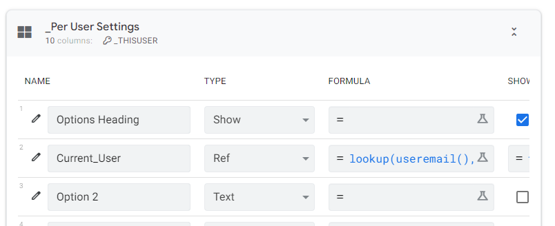

Similar to how I told you about a similar solution using Ref columns on UserSettings, this method makes use of the UserSettings and it's [_THISUSER] expression.
1. Use the UserSettings tab/table
This is mandatory for this to work and to be honest I almost always use it since I discovered it.
If you don't know about it, you can use it to filter your data via Security Filters, to manage UI preferences, Localization and so on.

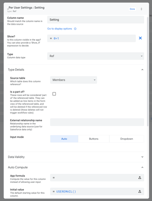

2. Let's configure one of the columns for this
Take any column (I tend to use the last one) and tweak it this way:
ConfigDescription
Column NameAny name descriptive enough, like "Filters"
TypeCan be Ref or Enum/Ref
Show?Important, we want this column to be available but the user should not see it. To make it work this way, activate the "Show?" but add an expression that always evaluates to false. I use 0=1 because I'm weird and I like numbers. So an expression that returns false is not the same as unticking the option
Initial ValueAssuming that the way you filter your Users/Filters table is by email, use USEREMAIL() here. You can replace it with any expression that returns the value you use for ownership of the row. Remember this should be a value, not a list
Referenced table nameIf you used Ref column type, the system will ask you to point to the Users/Filters table. If you don't and you selected Enum, make sure that BaseType Ref and Referenced table name are configured properly, as well as Valid If

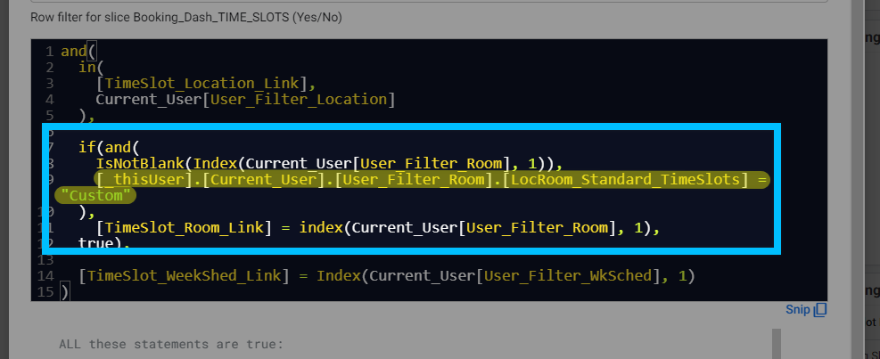

3. How to use it, what's different
Since now you have a ref to the Users/Filters table you can use a dereference expression like any other, which follows the same principle shown on the Ref on UserSettings article.
Retrieve a value from Users/Filters table:
Show More
Before:
INDEX(CurrentUserSlice[ValueColumn], 1)
// or
ANY(CurrentUserSlice[ValueColumn])โ€‹
After:
[_THISUSER].[Filters].[ValueColumn]โ€‹

I tested it and it worked even for users that have never opened the Settings form.
It's important that is done properly the first time, all of the show if condition and initial value, so that after our users get their local copy of the app, the app receives the new UserSettings field and applies the Initial Value automatically
I've tested this before and can confirm that USERSETTINGS() always gets the initial value upon initial sync/open of the app and SECURITY FILTERS works well using those initial values.

What I found more reliable is instead of using the Initial Values, I baked it into the app formula instead.
For the benefit of others reading this, the idea is this:
instead of using ANY(currentUser[Column]) or INDEX(currentUser[Column]) to refer to some columns in the current user, do the ff instead.
Create Columns in User Settings for each of Current User slice fields you will use throughout the app.
For example, if my currentUser slice will have [Emp ID], [Role], and [Email], create those columns in User Settings as well.
Next, assign app formula for each of the User Settings columns as follows:
[Emp ID] uses INDEX(currentUser[Emp ID], 1)
[Role] uses INDEX(currentUser[Role], 1)
[Email] uses INDEX(currentUser[Email], 1)
Now, whenever you need to use it, simply use [_THISUSER].[EMP ID] which is equivalent to using INDEX(currentUser[Emp ID], 1)

1) I made a Current_User UserSetting

2) From this I then chain deref`ed the value I needed inside my slice formula
1e93a14b-e34f-43f1-a99f-7316e3abbd7b
I could migrate everything inside this formula away from the Current_User (slice), and I likely will eventually.  First I'll run this setup through it's paces, see if I can't break it.
I really like how clean this is though (^_^) ๐Ÿ‘

@SkrOYC Thank you so much for the great tip! It change my messy expression so neat.
But I have one problem. I'd be very appreciated if you give me some advice.
When I use "Preview app as" option in the editor, the usersetting won't be overwritten. It stays as it was
โ”โ”โ”โ”โ”โ”โ”โ”โ”โ”โ”โ”โ”โ”โ”โ”โ”โ”โ”โ”
1-1. If I change "Preview app as" from UserA@gmail.com to UserB@gmail.com and press apply, the usersetting filter column won't change.
1-2.When I turned on the show? option of filter column to look into, it stays UserA@gmail.com. But If I change column value manually to UserB@gmail.com the app works as thought.
2. If I enter USEREMAIL() also in the app formula and press save in the blank user setting view (because show? is false), the filter column value is overwritten.
Is this tip can't work on "Preview app as "? Or Do I mistake something?
Here is my Usersetting Filter Column. (I name the filter column "Setting")
Technically you are correct. Since you have everything configured properly, it seems like Preview as is just not updating the cache data for the usersettings section, although as far as I remember it should be reseted every time you save the app.
Could you try this?
  1. Use a "Preview as" email of your choice
  2. Change something in the app and Save that change
  3. Check if the user setting is applied for that user
My guess is that "Preview as" doesn't trigger the cache reset for usersettings as Save does
Great! The save button works well; the user setting is applied for the changed user automatically.
Thank you very much!
