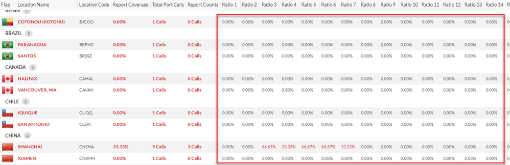

This first screenshot demonstrate that the field values of fields are made visible on table view.

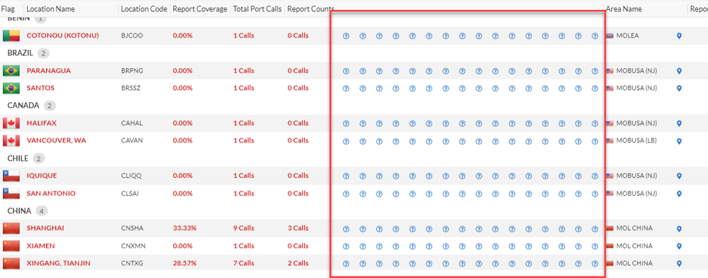

Then when I added the inline action for the fields, the table view looks like this.
Actions for each field are indeed available, but it sacrifices the visibility of field data value, as Appsheet is natively “hide” those.

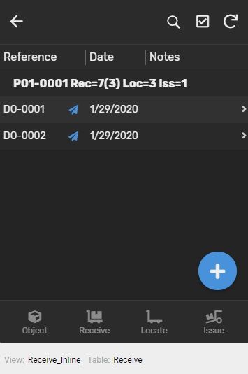

Okay, I am fully wake up ! This is the original table view.

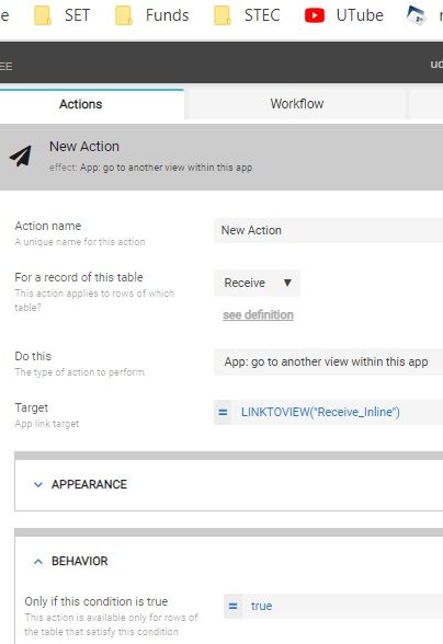

Then I created an action name “Test Action”, set it to be “Display inline” and attach to column “Unit”. With only this settings, this action is shown on both table-view & detail-view. Note that the unit column disappears in table-view.
2X_4_4da5f6d5c989eece652060a0464ce0062b2d0eba.png 2X_a_ae9af6e16b0afa243281f41a1aef1ff9cac8c13d.png

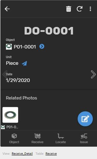

Now go to BEHAVIOR >> “Only if this condition is true” and put CONTEXT(“ViewType”)=“detail” therein.
And now, this action disappears on table-view and shows on detail-view only.
2X_6_6e2b5aff5af0a5afeec1e8c1cd9d726c766edd41.png 2X_b_b9213b988503e32a5654b996dd07a7a63f15c352.png
That’s all I meant.

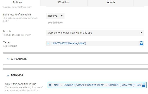

This step-by-step demonstration may be useful.
These are the original screen shots.
There is no action that I am going to add for “Receive_Detail”.
Now I add an inline action named “New Action” and attach to “Unit” column.
Now the “New Action” is shown on table view, inline view and detail view.
Now I change the action BEHAVIOR >> “Only if this condition is true” to
AND(
   CONTEXT("View")<>"Object 2_Detail"
   CONTEXT("View")<>"Receive_Inline"
   CONTEXT(“ViewType”)=“Detail”
This is to prevent the action shown on Object 2_Detail and Receive_Inline views. Save and see results.
You can clearly see that the new action is shown only in Receive_Detail view, not in Object 2_Detail and Receive_Inline (which are table views).
All you need to do is controlling the action in “Only if this condition is true”
