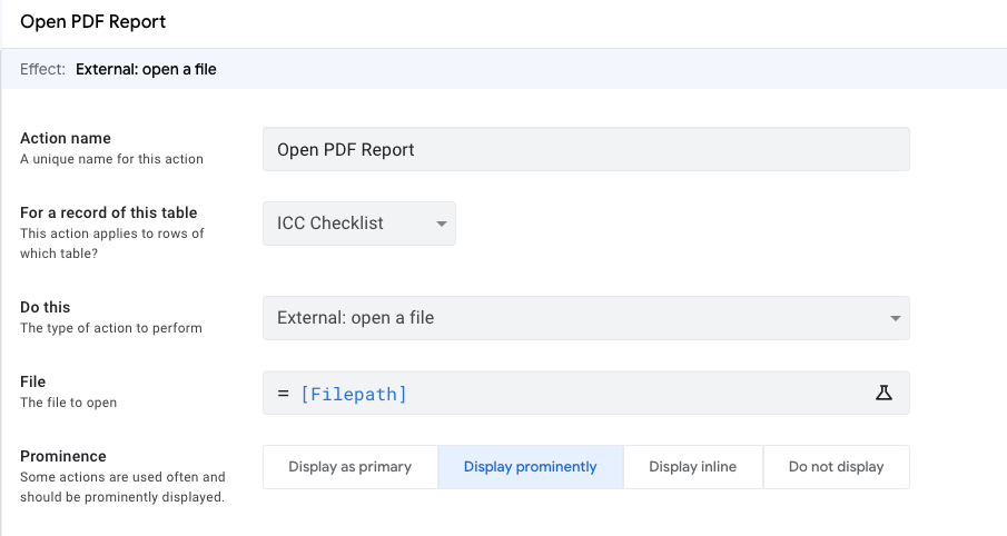

Hello, I have tried this solution but I cannot figure out how to keep appsheet from replacing my '&' with %26 before the file opens.  My action is setup exactly like your image but the link will say "...pdf%26abc..." instead of "...pdf&abc..." which causes a "File not Found" message.  If I manually change the % to a & and hit enter, it forces the reload that I was after, so I have informed my users of this work around, but I would prefer to get this solution working instead.   Does anyone have suggestions for passing an & through to the browser?
Thank you!
Confirm your expression doesn't have the & embedded within an ENCODEURL function.
Thank you for responding! I am not using the encodeurl function anywhere, though I have experimented with it in various places without success.   I have attached screenshots of my filepath expression and open action function (does not currently have your suffix).  I am on a mac using chrome,maybe there is some local conversion or something? Thank you again for your help!Screenshot 2023-07-25 at 8.40.49 AM.pngScreenshot 2023-07-25 at 8.39.43 AM.png

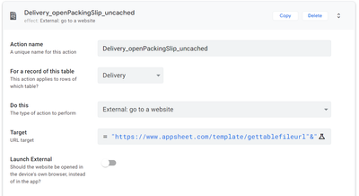

@dbaum Love this tip!! I've done similar things to prevent SVG images caching, but hadn't thought to apply it here.
I had some issues using just the [filePath] with external URLs, as it would not include the https://appsheet.com/template/gettablefileurl?.. piece. Are you including that upfront in your [filePath]?
This is as close to a reusable action as I could get:
"https://www.appsheet.com/template/gettablefileurl"
  &"?appName="&CONTEXT("AppName")
  &"&tableName="&CONTEXT("Table")
  &"&fileName="&ENCODEURL("file\path\staticFileName_"&[_THISROW]&".pdf")
  &"&"&UNIQUEID()

I'm having the same problem as KirbyBaylin.  I've set the file path in the field I create to be:
Concatenate("ResSummaries/",[Job Number],".pdf", "&", UNIQUEID())
I am placing the PDF files generated in the ResSummaries folder.  When I don't include the variable after the PDF in the string, it works great (but uses a cached version of the PDF).  When I add the unique parameter at the end using any of the methods described in the solutions above, I get two issues:
1) the "&" is converted to "%26" in the URL string in the new browser window that opens.  When I replace %26 in the URL in the browser it works after changing problem #2 (below)
2) the rest of the string seems to create an issue.  I get this message:
Error retrieving file 'ResSummaries/211.pdf': URL has an invalid signature.
If I delete the remainder of the string (that begins with "&appVersion=" in the URL after the unique ID I created, it then opens the file just fine.  I've tried it with "Open a File" action as well as "Open an External Website" action.
I am on a Mac using Chrome.  I'm hoping someone can shed light on this.  I'm trying to force the app to open the latest version of the PDFs it creates, not a cached version.
Thanks for any help!  Wick
I figured out what was wrong.  I was adding the unique ID to the path stored in the data field in the table.  It should have gone in the action to open the PDF document instead.  Once I did that, it worked great.  Thanks for the tip!
