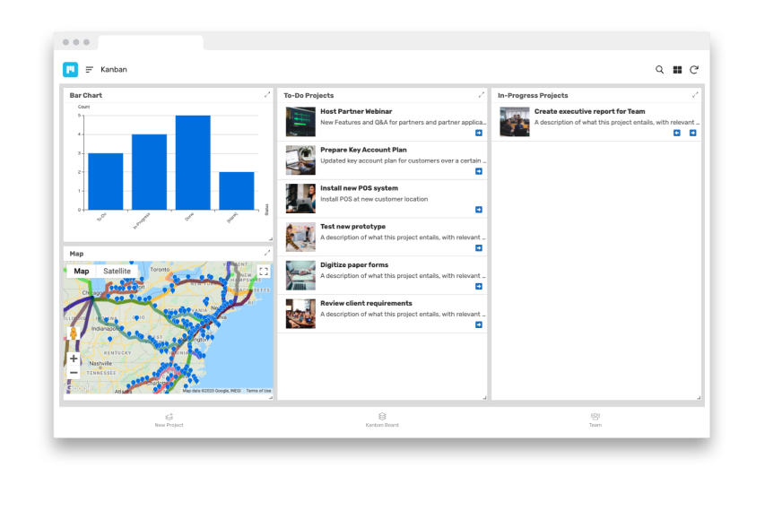

"photo" is where you need a URL string that will reach the Bot API. You can push a public URL like this one: https://www.appsheet.com/Content/img/heroimg/desktop_screen.png
