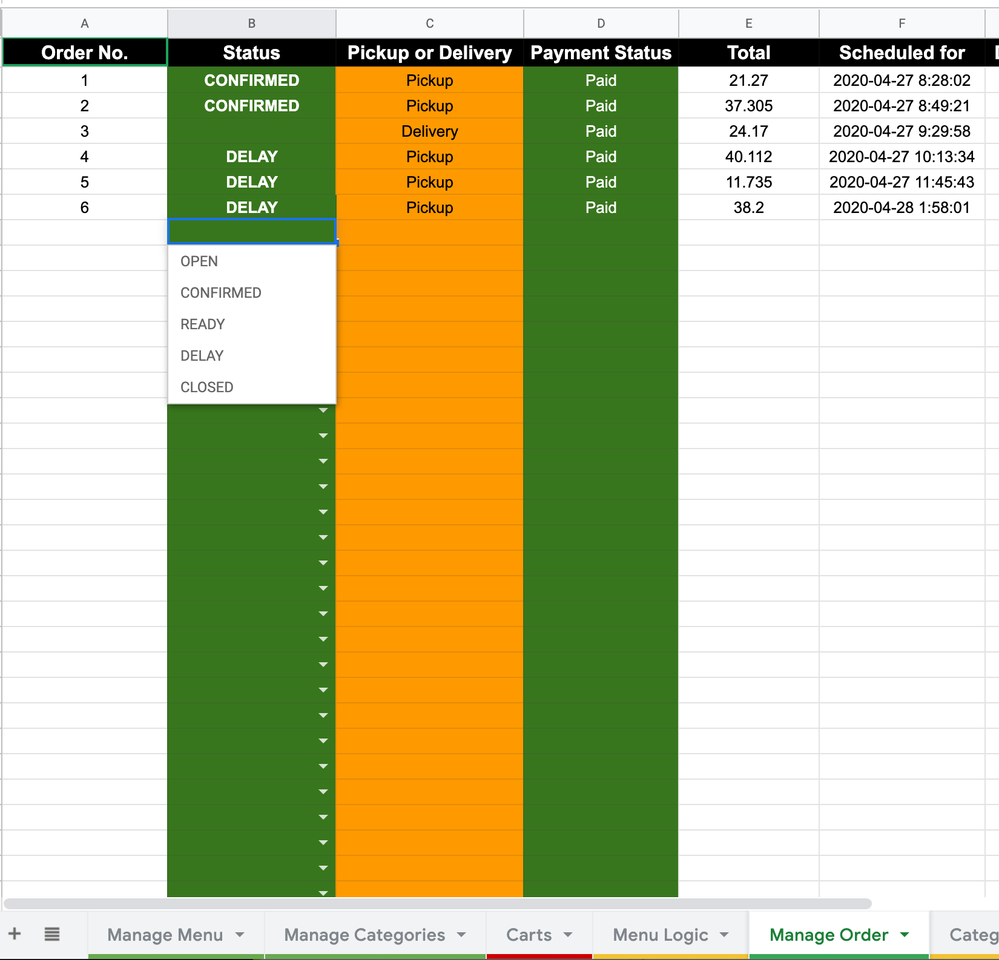

I think I figured out where to put the code. I have it like thisโ€ฆ
function myFunction() {
var ss = SpreadsheetApp.openById(โ€œ15D9Q7292xRY6I06Igrq3rqRoaR3TwT83PqtFF3Gytwwโ€)
var source = e.source;
source.getActiveRange();
Is there anything that Iโ€™m missing? When I run the code, it gives me an error of ReferenceError: e is not defined (line 3, file โ€œCodeโ€)
Is there something else that Iโ€™m supposed to be adding? Iโ€™m a little new to programmingโ€ฆ
The column that I want this to run on is Column B of this attached screenshot. Its the Manage Order Tab on the bottom of that sheetโ€ฆ
@5starbiz
  1. You need to set an onChange() trigger to make it work
  2. You need to add the event object as a parameter to your function
  3. You cannot use system parameters as variables; var source = e.source is not a valid statement
  4. Event object always refers to the active spreadsheet, therefore below declarations are the same:
var ss = SpreadsheetApp.openById(".....")
var source = e.source // though this statement is already invalid
function myFunction(e) {
You can wrap this function like this, which is more correct:
	var ss = e.source; // returns the active spreadsheet as 'event object'
	var sht = ss.getActiveSheet(); // assigns active sheet of active spreadsheet
	var rng = sht.getActiveRange(); // assigns active range in active sheet of active spreadsheet
