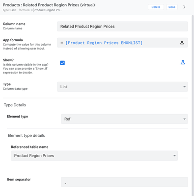

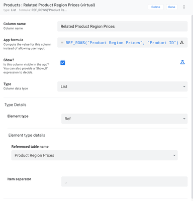

So if I use the manually created ENUMLIST Column in a VC that is instead of using something like this REF_ROWS("Product Region Prices", "Product ID") just if i use [Product Region Prices ENUMLIST] will this effect performance? I removed REF_ROWS () and it just generating a LIST VC with ENUMLIST.
Instead of this
To this  
Yes!
  • If you think about the REF_ROWS() formula, this is actually computing what should be in the list.
  • Creating a VC to display a list of values that's stored in a physical column...
    • that's a much easier task to complete
    • with significantly less steps
So yes, changing from a Ref_Rows() to a VC displaying a [Physical_Enumlist_BASE_TYPE_Ref] will increase performance at the sync, reducing the number of operations and speeding things up.
