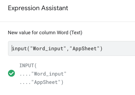

The expression is as follows:
In this case โWord_inputโ is just what I decided to call this function. You can make up just about any function name you want, I think. I set โAppSheetโ as the default but in my application the default is just a placeholder because my app doesnโt use it; it always takes the value from the other table. So, I think the default value could be just about anything and it wouldnโt make an important difference in my app.

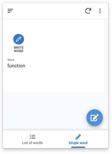

Before we go on, letโs take a look at how this action functions in isolation. In the app, Iโve set the action to display prominently with the label โWRITE WORDโ:

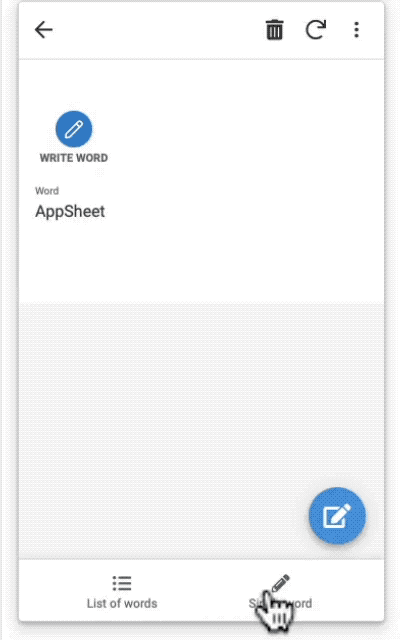

Iโll hide this writing action when I actually use INPUT() in a working app of mine but I made it visible in the sample. If you tap on it inside the โSingle wordโ menu, this happens:

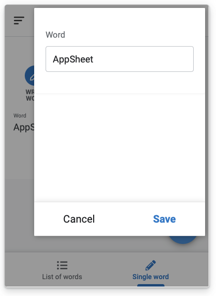

Since the action hasnโt received a value for โWord_inputโ, it asks the user to provide it. The next step provides that value so the app doesnโt need to ask for it.

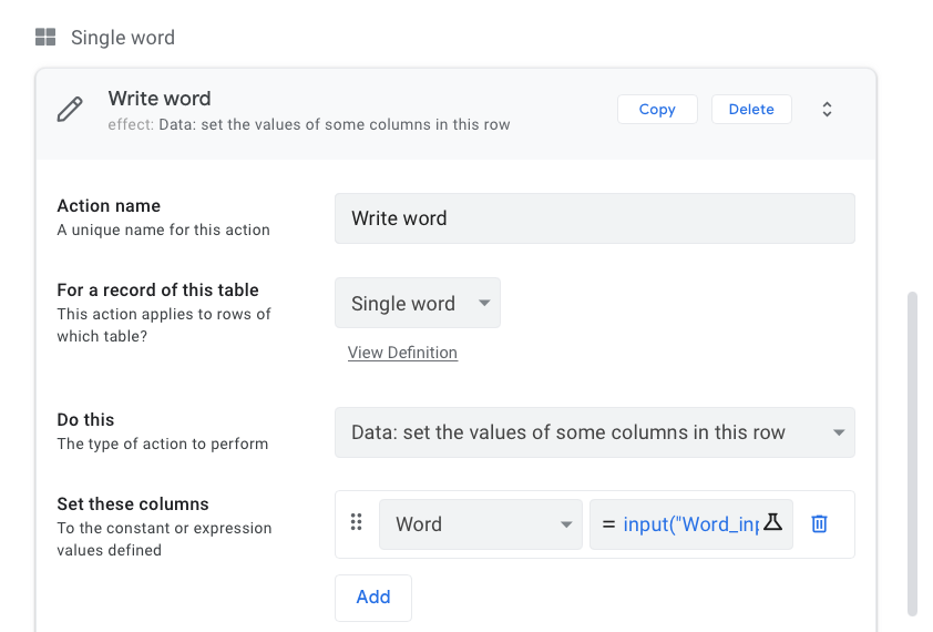

Since โword_inputโ was part of the referenced action, I was able to select it and define it with a column name.
Thatโs it!! Works just fine!
