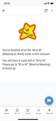

I've been pleased with how I can put even fairly detailed images in my app (at 600 x 280) with this method.  Here's the most detailed one I've put in so far:
This one obviously has a lot of detail (hair on the cat and strands in the rope, etc.).  The file I made with the method described above turned about to be a little over 200,000 characters.  So, I needed to split it into five pieces to put in five cells.  Still, my feeling is that five cells should be enough for any kind of illustration I can imagine putting in my app.

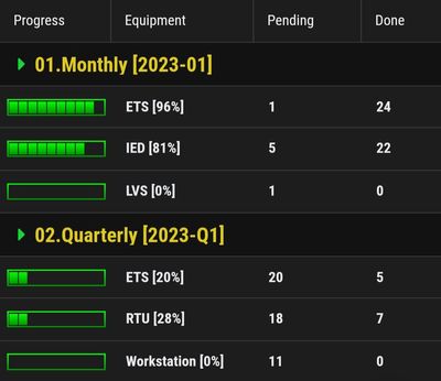

Another example of how useful this SVG tip has been for me
Very cool!!!  Could you share how you did it?  Perhaps you could write a separate "Tip" post, if it's not too much trouble.
Sure, will do that 👍
