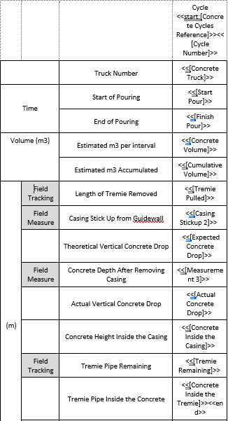

An example template using this method could look like this:

And there are all the pieces. Here is what this template would look like:
