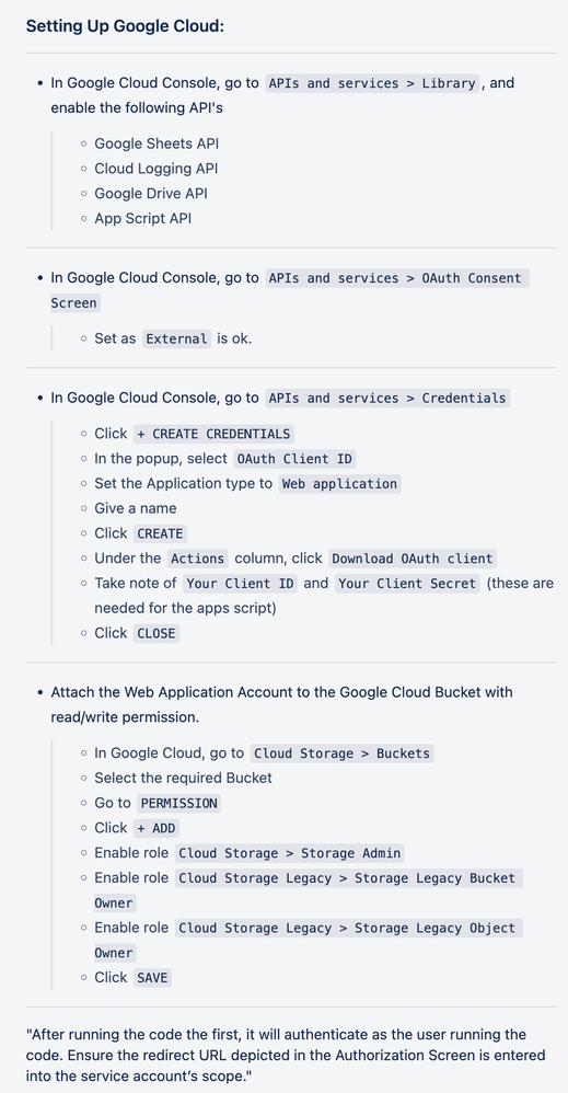

Hey TJ,
I have just 1 more question regarding the original article point 5:
"Ensure the redirect URL depicted in the Authorization Screen is entered into the service accountโ€™s scope."
Do you have any idea what that means, where i should be looking in Cloud Console, etc ?
Hi Mr_Shane,
This is a topic that I still have a few questions about.  It may also be where I may be running into my 'time out' issue, since I may have at some point tweaked my permissions to my Storage bucket, and that may explain why my scripts haven't been able to access the files and are now hitting time out limit errors. Lol
Here's my present understanding:
So there's two different kinds of 'service accounts.' By default, 'service accounts' are made by GCP as kind of general security monitor protocol, in order to de-link from any email address (personal or business). Think of a 'service account' as a general email account, but with no email inbox, or a general account manager that -- has a email address type of moniker (ie. such as: yourprojectname@developer.gserviceaccount.com). If you go to your:
Google Cloud > IAM & Admin > Service Accounts
Using a hypothetical thought exercise, let's say we have one called "ABC", as the default Compute Engine auto-generated service account.
That is where you should find the service account that is linked with your Google Storage bucket permissions by default. I think with any new GCP Project that you make, Google auto-creates a default service account, like a "Compute Engine' one was made in my project after I created the VM instance. You can either use the default service account or make a new one, but regardless as to which service account you use, I think it has to be linked to the Storage bucket permissions in order to function properly, but I don't know that part for certain yet.
However, that's not the same 'service account' that the article is referring to in point #5 per your inquiry.  At least, I don't think so -- I think the article is referring to a different type of 'service account'.
Instead, once you initially link your GCP Project ID number, by going into the Apps Script settings within you Google Sheets file, when that link is made, what happens is that another type of default 'service account' is auto-created by that link. But this new 'service account' doesn't show up in the 'Google Cloud > IAM & Admin > Service Accounts' section, but rather you can find it by going to 'Google Cloud > APIs & Services > Credentials' in your GCP Project.
In addition, when I tested these steps, I found an auto-generated 'OAuth 2.0 Client ID' that was called 'Apps Script', it was a Web application with a randomly generated Client ID.  I don't know if it's correct to call that one a 'service account' or not based upon Google's standards -- but I think that is what the article was referring to when it says 'service account' in Step 5.  That Client ID was not editable, but I found through testing that if I tried to delete the Client ID, then the Project was no longer linked to the Apps Script any longer, and nothing would work. So you have to leave that one 'as is' in the project.  I think it get auto-created as soon as the Project ID is linked to the Apps Script settings -- but it may also be once the script is first run -- I don't recall offhand since it's been a little while since I first linked the project and ran the script.  Either way, it should get auto-created early on in the steps of the process.
Using a hypothetical thought exercise, let's say we have one called "NOP", as the auto-generated OAuth 2.0 Client ID which was made by linking the Project ID to the Apps Script settings (or by first Authorizing the script during its first run, whichever is appropriate).
On top of that, I also had manually made a new 'OAuth 2.0 Client ID', as described in Step 2 of 'Setting Up GCP' per the article. And that is where I think that Step 5 is referring to as the 'service account' -- or in other words, whatever Client ID that you make in Step 2 as the Web application, it should be editable, and if you go into edit the OAuth Client, there should be a section 'Authorized redirect URIs (for use with requests from a web server)'. That's where I put the URL link that I had copied-and-pasted from the initial Authorization Screen upon first running the script in Apps Script.
Using the same hypothetical thought exercise, let's say we have one called "XYZ", as the auto-generated OAuth 2.0 Client ID that we made for Step 2 of the article instructions.
Using our same hypothetical thought exercise, we now have three different 'service accounts', or well two of them may not be exactly 'service accounts' but rather 'OAuth 2.0 Client ID's'. They are, once again, "ABC" as the default service account made by GCP (ie. not in connection with the Google Sheets Apps Script code). Then we have as the second hypothetical example, "NOP" as the auto-generated Client ID that represents the link between the Project ID and Apps Script setting. And "XYZ" is the Client ID we created in Step 2 per the article.  These all have unique looking 'email addresses' attached to them but none of them are email addresses with inboxes, but rather 'service accounts' that help us manage certain things within GCP.
You'll also likely want to ensure that the 'OAuth 2.0 Client ID' that you create, as described in Step 2 per the article, is added to the Storage bucket within the access, as a 'Storage Admin'. What is unclear to me is which ones should be added. In my testing, I've tried adding all three of them, including "ABC", "NOP", and "XYZ" into the Storage Admin access for the GCP Storage bucket. And I think that worked. I don't know if that's too much access or if all three of them need to be added to the Storage Admin, but I was having so much difficulty getting the script to run properly at first, that I just kept on adding permissions hoping anything would get through the security protocols! Lol This is what I was referring to previously when I said I think Google and other coding bodies have made security too complex. It doesn't feel intuitively constructed as a code base. I now understand a lot better the principles involved -- they made it so that large corporations or groups/teams could better manage projects, accounts, etc. and share access without giving away personal or business email accounts. But in doing so in how they have set it up, it adds way too many layers that are now required for something as simple as setting up a CSV copy to Google Sheet. It would be nice if Google just wrote the code for this type of link and made it available with a few clicks for us average coders and regular every day users. Having said that though, if we understand the principles involved, then in the future, we can better manage more and larger projects with these various levels of access creds.
Now, a lot of my feedback on this topic is my 'best guess' -- because, I didn't find anywhere else to add the Authorized redirect URL into the "ABC" service account. Unless you can find where to add it on there? Also, the "NOP" Client ID is not editable, so even though it's necessary, there's no other place where I could find to add the redirect URL except within the "XYZ" Client ID that was made in Step 2 per the article.
Feel free to post any feedback per your testing.

See the screenshot of current steps:
Hi Mr_Shane,
The instructions look good.  Thank you for compiling those instructions.
