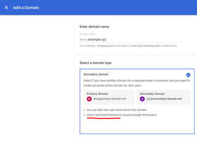

We are still technically within the 14-day free trial period. Before we do this, I do have a question: if we were to add another secondary domain (that has already been purchased, say one of my own for testing), is there a separate or additional charge for this (see screenshot below)? Or would it still be free as part of the trial? I do not want them to be charged just for trying to add a secondary domain as a workaround.
Thanks again for your help.
