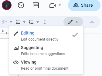

@dalkesm You have this pencil icon from where you can choose it:
Basically, you can use it as and when you need it,automation while you are an owner may not be possible considering the fact that commenter is not a good option for an owner

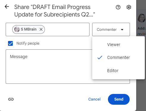

I think what works is that when you "share" your Doc, you can place your collaborators in "commenter" mode. Here's a screenshot. I don't know why they don't call those two items the same thing. ie. why would they call it "suggesting" whilst in the GDoc, but when sharing it is called "commenter". It is very confusing.

By reading my previous posts you would see that this latest suggestion does not work. The point of setting up "permanent" suggesting is for the others with whom I share the Doc. I, myself, can remember to select "suggesting" mode when I enter my own document. The problem is not being able remind everyone else who enters the document to go into suggesting mode. So my solution is that when I share the document, I just place them in "commenter" mode. Then I don't have to chase everyone to remember to put themselves into suggesting mode.
