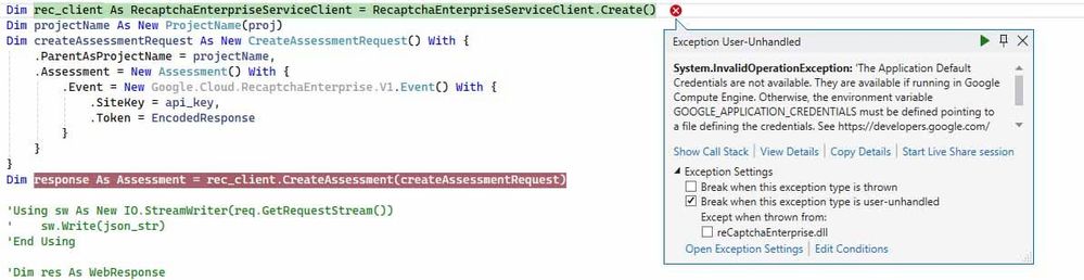

Nice! When you say "that asks for a google credentials file", do you mean you receive an error response from the createAssessment call to that effect? Maybe a sample of that error would be helpful to debug.
The front end is fine and it passes the token to the backend.
The error I get in the "bad boy" code is where the backend code tries to create RecaptchaEnterpriseServiceClient. Th error says the Application Default Credentials are not available ....
I hope that is readable.
Hi Sean! One of the Customer Engineering Specialists on reCAPTCHA Enterprise here, and happy to help.
This message is referring to the Application Default Credentials. You can learn more about it here, and then follow the flow here. From a high-level, you have two options:
  • Create a Service Account and download the JSON file as outlined here. After, set your environmental variable GOOGLE_APPLICATION_CREDENTIALS to point to the JSON file.
  • Set your Application Default Credentials (ADC) by using gcloud CLI and then issue the gcloud auth application-default login command. More info here

HI Chris,
That worked!  I installed gcloud cli and ran init. then I ran:
It responded with:
Credentials saved to file: [C:\Users\Sean\AppData\Roaming\gcloud\application_default_credentials.json]
I set the environment variable GOOGLE_APPLICATION_CREDENTIALS to that filename and poof it worked.
