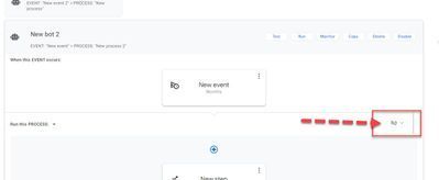

I see this new feature is rolled to free account, and just quickly did a hands-on test.
Once we make a Process not to be reused, then there is no way to turn this setting back ON, as this process is disappearing from the Process tab.  There is no toggle UX inside the bot | process config.
Or is something I'm missing from?
@Rachelgmoore
@takuya_miyai
Reply to my previous own post.
I found a way to do this.
Was difficult to find a way out.

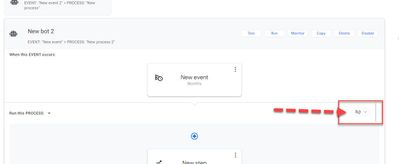

@Rachelgmoore
Quick suggestion is to place toggle button somewhere here?

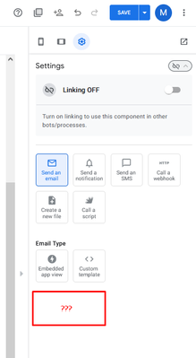

Here are a couple small issues that I found:
  1. Clicking on the blue "Go to: Process" link, on an unlinked process, takes you to the "Processes" page, but unless you already had the "show all" selected on that page, it doesn't actually take you into the process, so that is super confusing.
  2. On a linked component, you get this nice list of all of the related components that use it, and they are navigation links directly to those other components, which is great. But once you unlink a component, you no longer have that handy link. I would still very much want that quick link, like from a process/event to the bot itself. 2 screenshots below to clarify.
