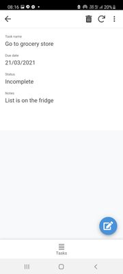

Hi, thanks for the reply. Still a little confused. When i tried the other template there is this add and edit button (may be i have phrased my question wrongly.)
Before, the add and edit button was on the appsheet but whilst i was working on it, i just went missing so now i cannot add any new task or edit the old ones.

Hi @naea07
Yes, there is a confusion ๐Ÿ™‚
The first screenshot is a deck view type, which means you have a set of records. In this kind of view, you have a "Add" button.
The same happens with Table view type, map, gallery for example.
The specifics of a deck view type is that you can display actions that apply to one record at a time, such as Edit or Delete in your case.
The second screenshot is a Detail view type, which mean you see the details of ONE record, and not a set of records. Here, the Edit button is displayed prominently. The Delete button is in the top-bar.
But you won't have the "Add" button, because it can't be displayed on a detail view type.
I hope my explanation make sense?

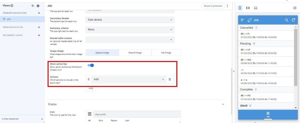

Hi @naea07
You should have an option for this deck view for displaying the action bar ๐Ÿ™‚
Hi, @Aurelien not too sure how to display the action bar, is it possible to provide a detailed instruction? Attached is what I have tried but both didn't work. 1678811351523.jpg1678811312584.jpg
1) Your Add action shouldn't have any conditions under "Behaviour", unless you really want that.
2) The "Action bar" is what is shown inside each tile of the Deck view, you generally don't want Add in there.
3) Check your Job table config, maybe you made it Read only
@SkrOYC OMG thank you so much! Can't believe I somehow managed to change it to read only without realizing ๐Ÿ™‚
