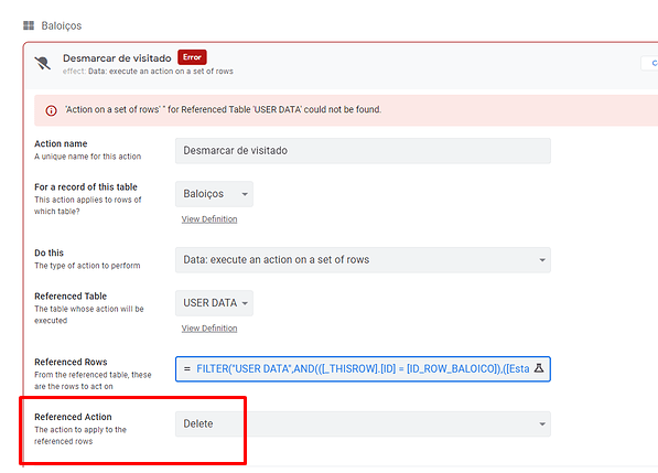

Hello everyone! I try to delete a row on table โ€œuser_dataโ€ with a action button on table โ€œbaloicosโ€. So i try this on Referenced rows of an action:
FILTER(
โ€œUSER DATAโ€,
AND(
([_THISROW].[ID] = [ID_ROW_BALOICO]),
([Estado] = โ€œVisitadoโ€)
This is the action:
The errors:
โ€œAction on a set of rowsโ€™ โ€˜โ€™ for Referenced Table โ€˜USER DATAโ€™ could not be found.โ€
Can anyone help me. 5 days around this and not solve the error.
Thank you all in advance!
Try to change this to something else, then change it back to the delete Action that you want.
OMG!!! IT WORKS!!!
Thank you a lot my friend!
