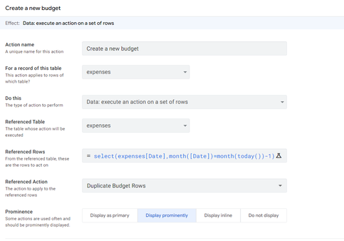

2) Create an action of type "Data: execute an action on a set of rows" that selects the rows to be duplicated and sends to the action created in #1.  The expression in this action assumes that you are copying the rows once the actual date is in the new month.

I done the process like you wrote, i guess.
But, when i click on the action, i see 4 adding rows, so it should be work, but
when i check on the database on google sheet, i see nothing addings
Probably the issue comes to the Prominence ? what do you think about ?
Thanks again

Yep it was my issue, i changed my key and i forgot [_THISROW] in my expression.
select(expenses[_ComputedKey],[_THISROW].[Date]=[Date])
Computedkey is key concatenate with [Date] and [ID]
Now its work Thanksssss !!!

Just a last question.
I tried to run this action on View Budget, because i want that trigger after addings a new [Date] on Budget.
But as both actions are referenced in table expenses, i cant triggered it.
I thought about to make a bot ?

In the action #2 I mentioned in my prior post, set the "For a record of this table" to the table from where you wish to start the copy process.  Budget in your case.  Leave the Referenced Table set to Expenses.
