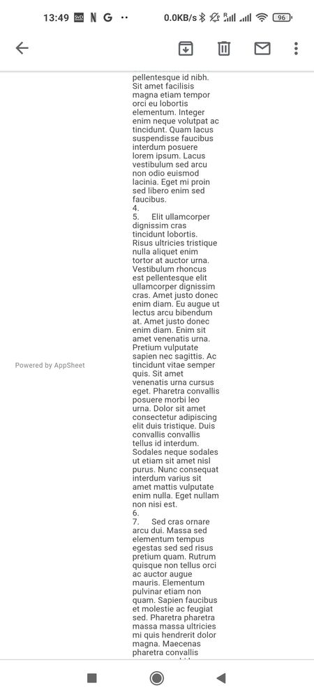

  1. If I open the same email on an Android phone, the message is not cut off but the left margin is too big and the text โ€œpowered by Appsheetโ€ appears a bit randomly in the margin half way down the text:

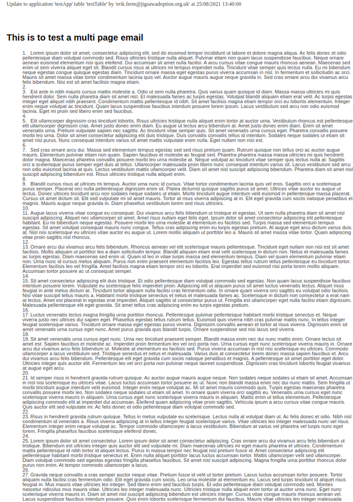

This is the resulting email using a Word template
Screen short MS Word templateScreen short MS Word template
And this is the result using a Google doc template
Screen shot Google doc templateScreen shot Google doc template
