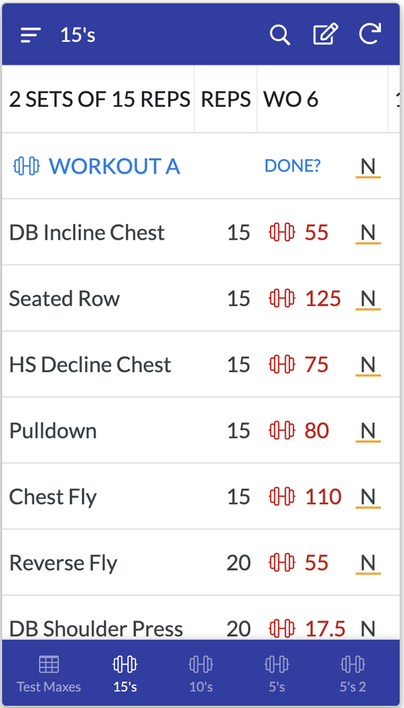

This is happening again. Yesterday, all of a sudden the font changed again (and the line spacing between rows as well), without me making any adjustments. This is happening in the browser interface app edit screen as well as on the iPhone AppSheet app.
First screenshot is what it should look like, and what it looked like before yesterday. Second screenshot is how it started looking yesterday, out of the blue.
Can this be fixed again?

@David_Ames , could you tell us what your Text size is set to in the Options tab?
The text size is set to the same size it’s been set to since the beginning of time…since I started creating apps with AppSheet many years ago. I have NOT changed any settings anywhere. This change in font size/spacing just happened randomly yesterday, without me doing anything. The same as when the font size changed randomly a few weeks ago, when the tech team at AppSheet discovered it was a bug on AppSheet’s end.
Anyway, my Text Size in the Options tab is set to: Lato 24 (again, the same font and size it’s been set to since I started working with AppSheet many years ago).

We definitely hear your frustration. The Material updates we’ve been doing in the past weeks use 16px as the default font-size for the base, which is why existing apps that have any font-size greater to 18px had the impact you’re mentioning. Our recommendation is to update the font-size to be smaller than what you currently had under UX>Options.
We know this is inconvenient for App Creators and we apologize, however we did not want to make actual changes to existing apps and there was no easy way to do a full pass on font-sizes without impacting everyone.
We hear you and appreciate you voicing your concerns regarding the changes we made, but do know these changes are made to give you and your users a better experience in the long-term.

This is unacceptable. Making the font size smaller, as you recommend, makes the font size smaller. The row height is still proportional to the font size, even when I set the font size to 16px as you recommend. But then the font is too small, and the row height is still too tall in relation to the font.
There is a reason I set it to 24px. So it can be read by everyone.
We shouldn’t have to make adjustments in the UX on apps that we have had for YEARS, that have behaved a certain way that people are used to. WE APP CREATORS should have the option of changing layout features (like making the row height bigger, which is what happened RANDOMLY the other day!)
