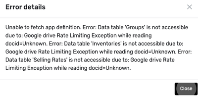

I get "Errors": "Error: Data table 'Buildings' is not accessible due to: Google drive Rate Limiting Exception while reading docid=Unknown....
Please help me solve this. I am in the creation/development phase and was just implementing conditional tasks in my app

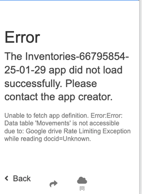

Receiving the same error for both of my apps!

Could you look into this issue soon? All the apps are blocked.
The issue is with tables in the application which are mapped from GoogleSheet.
Hitting the same issue on all my apps.

AppSheet experienced rate limiting from the Sheets API from 12:30am-2:30 am Pacific. Apps backed by data in Sheets were seeing errors during this time. The issue has now been resolved. We were unable to post this incident to Cloud Status this morning. Better external comms will discussed as part of our internal postmortem process. I sincerely apologize for the disruption.

For RCA, the root cause was a Google Sheets automated cleanup change that incorrectly removed an active internal configuration flag (an in-use experiment flag). This led to failures within the underlying Decoupled Docs storage system which AppSheet apps use if their data is stored in Sheets. The Sheets team took corrective action and service was restored at 2:30 am PST.
As to Cloud Status updates, this incident will not be getting posted there, but I recognize that this is a gap for us to address and it will be addressed as part of the postmortem.
