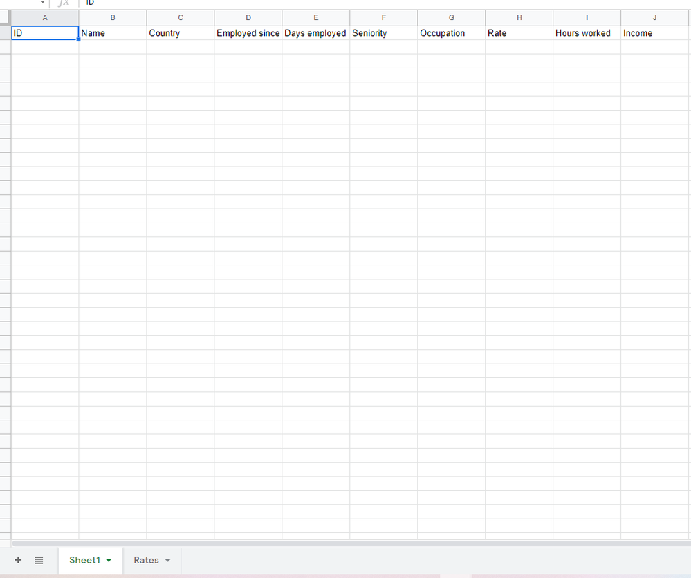

I currently have two tables.

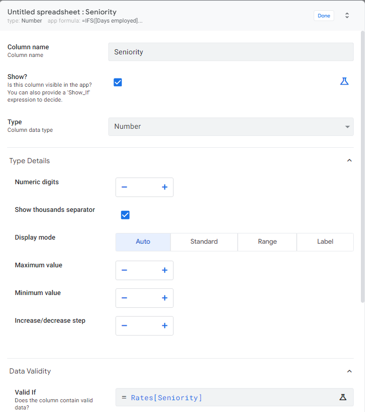

I am currently using Data Validity Valid if to get the data from table Rates
This has been working well to create a dropdown list of options based on table Rates and the data that the user chooses.
I’m not facing any problems with Country and Occupation as I want the user to actively tick one of the available options. I am also not having any issues with Seniority as the formula I am using IFS([Days employed]>60,3,[Days employed]>31,2,[Days employed]>0,1,) is working well.
However, I am having problems getting the app to automatically choose Rate. Currently, the correct rate shows as the only option, but the user needs to actively tick it. I need the app to choose it.
I have read the link you provided. I have watched the video in the article. Maybe the answer is there, but I just can’t get it to work. So any further assistance would be very appreciated!
