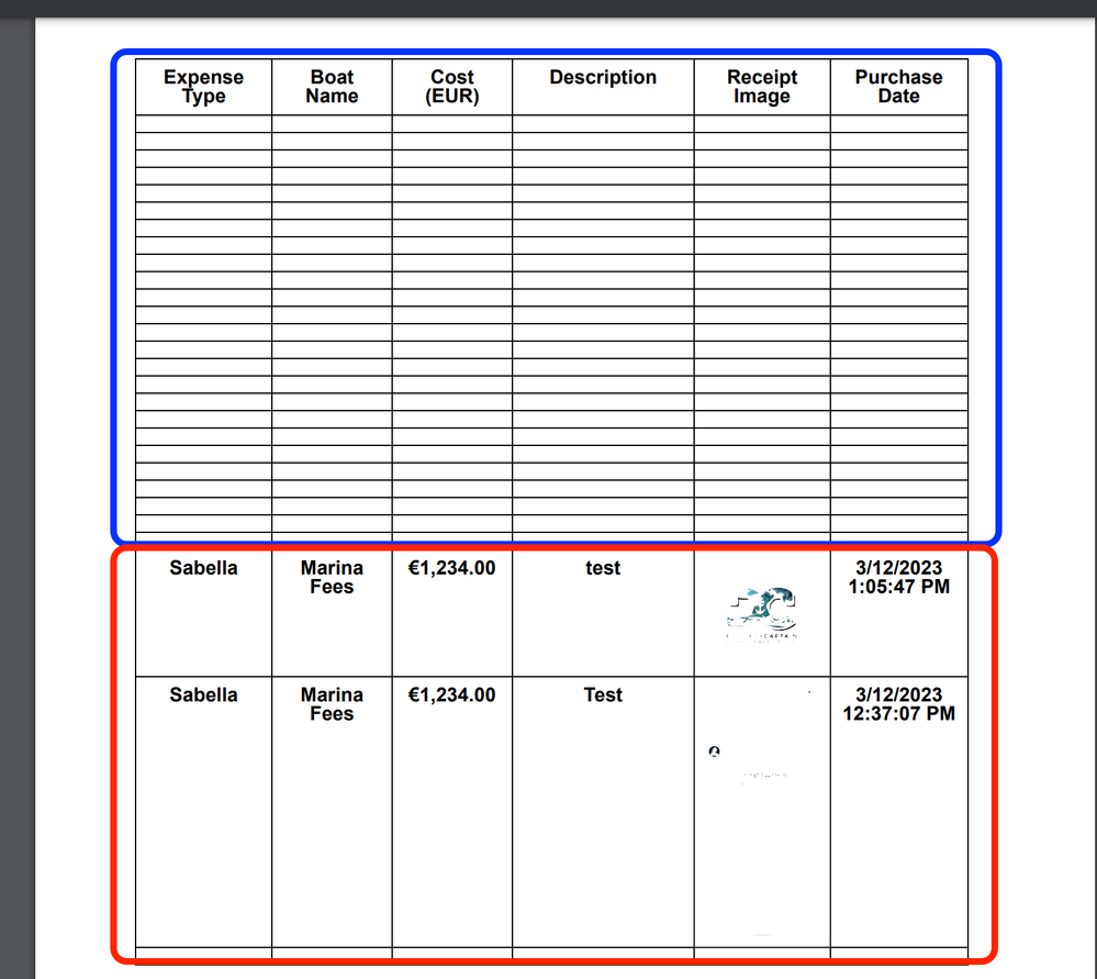

I'm trying to find a way to remove empty rows from my pdf report, I have several projects that use the same data spreadsheet. When I filter the data to create a PDF report, it keeps empty rows from other projects. Can anyone help me with the correct expression that removes all those rows from the report, and keep the report clear and a nice view of the report that shows only filtered data?

I'm describing the results of empty rows, and not columns.
In the screenshot, you can see blue and red sections each one representing a different project in my main data spreadsheet. When I generate a report for the Blue project, It shows me a proper view from the first row to 26 (Simply because the Blue project was the first in my main data sheet),   Now when I try to generate a report for the Red project it includes the first empty 26 rows  (those rows already have data related to the blue project but shown as empty because of filter)
How can I remove those Blue rows and have only the last two rows in the report?
I tried the IF(ISNOTBLANK expression, but it doesn't work, probably I do something wrong / or use the expression incorrectly.
Sincerely

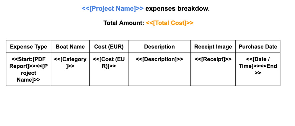

Basically, I think that my problem is not the app expressions, I believe it is a problem with my PDF template with expressions:
<<Start:[PDF Report]>><<[Project Name]>> <<[Category]>> <<[Cost (EU R)]>> <<[Description]>> <<[Receipt]>> <<[Date / Time]>><<End>> .

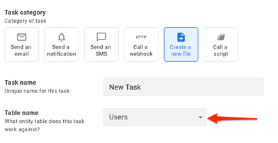

Confirm that all these columns are from the same table that is selected in the Create a file task's Table property:
