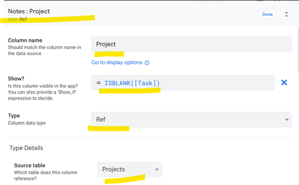

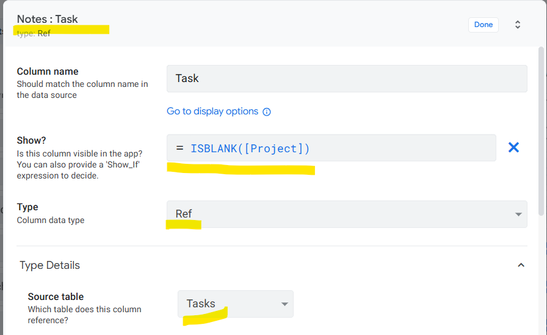

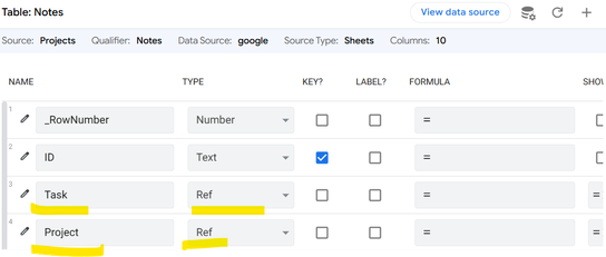

Please try below for having notes option both in Projects and Tasks table.
Please have two reference columns [Task] referencing Tasks and [Project] referencing Projects table.
The configuration of the [Task] column to be as follows
The configuration of the [Project] column should be as follows

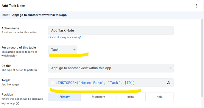

The action "Add Task Note" in the Tasks table should be as follows
