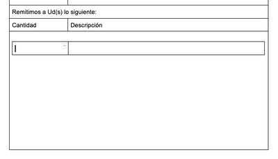

I made a BOT in my app that generates an invoice in PDF format with the customer's information and the sale details (list of products purchased).
So far everything is perfect, the problem I have is when I use Google docs, the PDF is armed with a table and every time I add products, the table goes down and goes to another page.
Is there any possibility to make a table with a fixed size so that each enter or line break (added products) does not increase the size of the table in Google Docs?
Thank you!

What you may simply want is to remove the cell borders--that might achieve the display you're seeking.
Alternatively, try embedding another table within the minimum-height table cell. For example:

Ese es el invoice, cada vez que agrego productos <<PART NUMBER>> <<PRODUCTOS>> la tabla aumenta el tamaรฑo y baja una linea.
Hay alguna manera de colocar la tabla con tamaรฑo fijo?
Gracias!
That is the invoice, every time I add products <<PART NUMBER>> <<PRODUCTS>> the table increases in size and goes down one line.
Is there a way to set the table to a fixed size?
Thank you!

Ya que tu expresiรณn start...end cruza mรบltiples celdas de una fila de la tabla de la plantilla, AppSheet siempre agregarรก una fila nueva por cada registro de cantidad/part number/producto/serial--tal como @SkrOYC lo ha explicado.
Si no funciona la tรฉcnica que sugerรญ de incorporar una tabla de varias columnas dentro de la celda mayor, quizรกs probando combinar las dos columnas consigues lo que necesitas. Podrรญas separar los valores con la tecla de tabulaciรณn.

Maybe I misunderstood the issue you're facing. In both MS Word and Google Docs it's indeed easy to specify the height of a table row. For example, here's where to do that in Docs:
I thought the issue you are trying to overcome is that you want the multiple rows output from AppSheet to appear without internal borders in between but still outlined with an external border. Try posting a screenshot of your desired finished product. Several community contributor--especially @SkrOYC who already replied--are template experts and if there's a way to accomplish what you need they'll know.
Thanks! @dbaum
This was the solution, place a table inside another table with white frames.
I didn't understand it until I made several practices with the "Minimum Row Height" option in 15 cm and it was perfect. The only thing I lose is the line of the "Quantity" column that separated both columns, it was also perfect.
