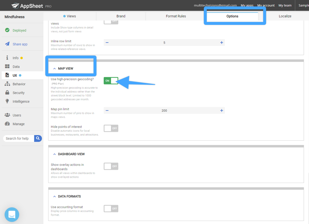

@Praveen sorry to add even more to your workload. But if you are looking at the timestamp to make it more secure, can you do the same with the GPS location? One issue we noticed about 12months ago was that if you are on wireless, sometimes Appsheet uses the internet connection location, presumably via the DNS record. Is there any change you can force Appsheet to only use the GPS receiver?
How we worked this out was with the above company sometimes they couldn’t clock in. I went to site and ran some tests. Google Maps was reporting my location correctly but Appsheet was getting a location about a mile away. When I turned off wireless on my phone and Appsheet then got the correct location.

@1minManager you’ve seen this right?
@MultiTech_Visions yes. But its not clear how it works. We can have 40-50 people doing multiple time entries per day, and each one has a Change_Location on both the start time and end time. So the limit of 1000 is potentially not enough. Also its not clear why this limitation is in place if its just pulling a Lat Long from the GPS receiver.
