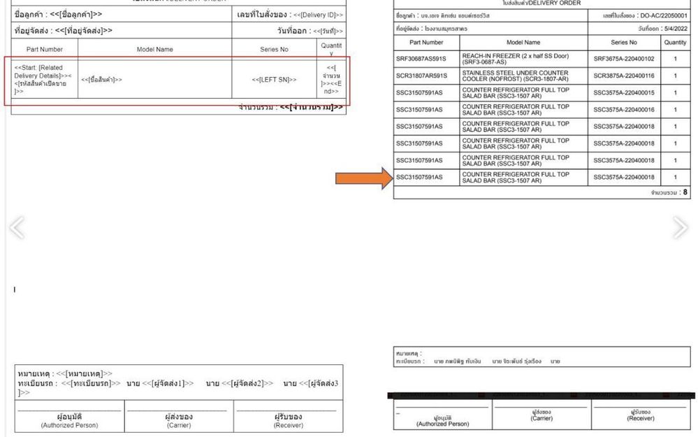

[Problem] Generate PDF File with Start Expression
Hi all,
Left picture is my google docs template and as higlighted in red is my child table within it (Related Delivery Order). When I generate PDF file, the row is create depending on delivery order I have but unfortunately, the row that is generate from the child table push my signature, comment data to be over the page as shown in right picture.
Any solution to fix the row from child table so it stay within the page?
Thank you all

I am not sure if this will solve your problem but unless the number of child rows is always below a certain number (in that case, you should adjust your font size to always fit everything in one pate) , there is no way to ensure that.
One thing I would do is to have your signature line at the top so that it is always on the first page.
Thank you for your suggestion. I think that by adjust font size will not work.
If there is no other solution I would have to put my signature above the page instead.
Yes, AppSheet workflow/report templates currently do not inherently support pagination.

I think with HTML you can place your signature at the bottom ("footer") of the page no matter the content before ir

I could make an HTML template for you if you share me your current one
I am not good at coding. Is there an easy way for me to solve this problem?
I don't think so, because it seems it's not supported. I'm offering you a workaround if you send me your current template to make a new one using HTML/CSS for you
