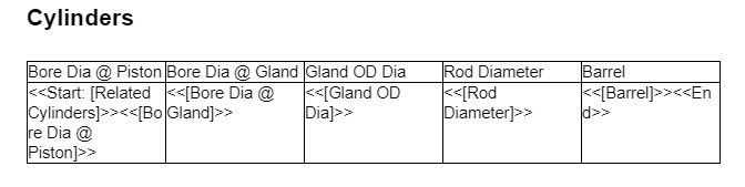

But when I reformat it like this:
 It breaks like this:
  • Error 1 : 'Email Quote' task 'Sending Quote' Attachment template. Expression '[Bore Dia @ Gland]' is invalid due to: Unable to find column 'Bore Dia @ Gland'.
  • Error 2 : 'Email Quote' task 'Sending Quote' Attachment template. Expression '[Gland OD Dia]' is invalid due to: Unable to find column 'Gland OD Dia'...........
This goes on for every column. Note that the initial column of "Bore Dia @ Piston" seems to have processed correctly?
No idea why it fails. I used the same start expression. The end expression is located after the last column contents

You may want to try the below format
Also not sure why you mention there can be only 5 columns in the horizontal format, the below report has 6 columns
The corresponding template is as follows
