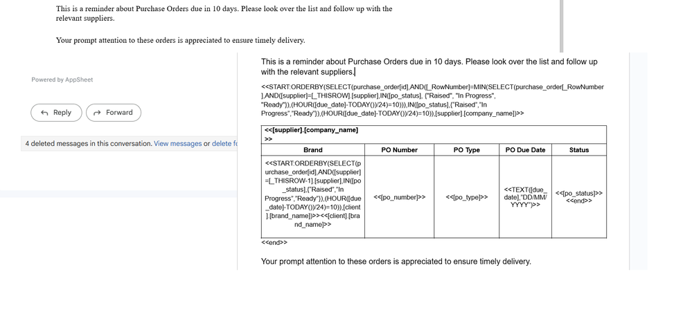

Apologies for the confusion but I'm experiencing issues with the template formulas.

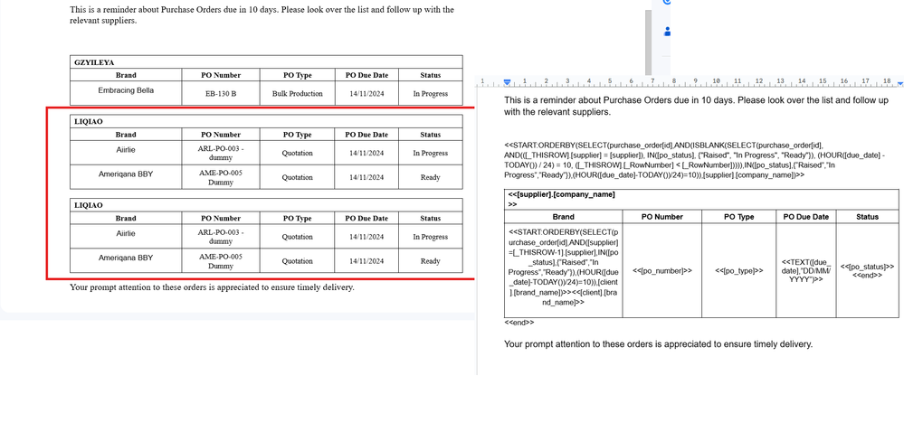

- Formula 1: The emails I receive contain duplicate data. Please see the red highlights for reference.
-Formula 2: The email is delivered, but no table appears in it

In #1, is your 3 rows appearing as you think.. meaning the test should show you 3 rows/tables?
In #2, it sounds your first Start: & End loop gives the zero rows meaning there isn't anything to add. Is the SELECT() bringing any rows?
For the duplicate, you might try wrapping your SELECT() in UNIQUE(), it will remove duplicates - which will prevent the <<START from looping through them.
It sounds like using the UNIQUE() won't help in this case because when using Start & End expression, it already generates a list of key column values, which are unique. In this case the 2nd Start & End expression is just filtering wrong rows inside of a table.. and they don't have anything to do by each other. It's just a loop inside of another loop.
Try this as the outer Start tag:
<<Start: ORDERBY(SELECT(purchase_order[supplier], AND(IN([po_status], {"Raised", "In progress", "Ready"}), ((HOUR([due_date] - TODAY()) / 24) = 10)), TRUE), [company_name])>>
 and this as the inner:
<<Start: ORDERBY(SELECT(purchase_order[id], AND(IN([po_status], {"Raised", "In progress", "Ready"}), ((HOUR([due_date] - TODAY()) / 24) = 10), ([supplier] = [_THISROW-1])), TRUE), [supplier].[company_name])>>
For the outer START expression, try..
<<START: ORDERBY(
 SELECT(
  PO[id],
  AND([_RowNumber] = MIN(SELECT(PO[_RowNumber], AND([supplier]=[_THISROW-1].[supplier], #rest of restrains here#)
[_THISROW-1] is the difference. Also you do not need to apply the same restrictions to every select statement but one.
I've made a few adjustments, and it's working now.
