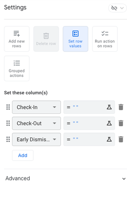

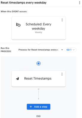

Good day all. I have two scheduled bots that do not run automatically at the scheduled time. They run fine when I run them manually and test them. The app is deployed and I have bypass security filter enabled. Is there anything else that I am missing?

Though I was having issues before with this, I decided to change my Daily schedule to Weekly, selecting M-F instead. That is the only thing I changed, and it appears to have worked. Still not a resolution to the Daily issue, but it is all that I need. If anyone experiences issues with the Daily, I suggest talking to support. There were no other solutions that I could determine.

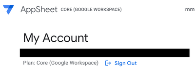

I switched the scheduling from Weekly to Daily set for the same times, but it still did not do it automatically. Also, when I ran it manually, it recorded the timestamp differently than what it is. It is the 18th 5:10pm and instead it saved as 20240419_001050. I have Appsheet core:
And here is what the deployment says about plans:
