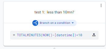

In my opinion, you can manage this with only one bot and a serie of branching components.
EVENT CONDITION
TOTALHOURS([datetime]-NOW())<1
PROCESS
A serie of steps with "Wait" then "is less than 10mn?"
with the branching part being:
with expression:
TOTALMINUTES(NOW()-[datetime])<10

Attention
Please note I didn't test this.
Let us know if that works for you ! 🙂
