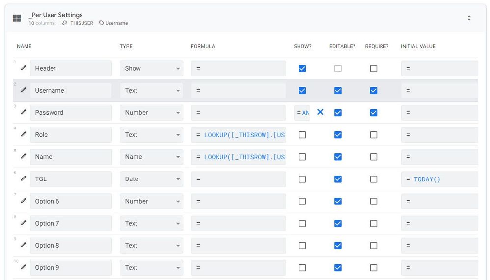

i have two table (tracker and outbound) in this case I want an add button in the outbound table is show, so that users can request materials based on the plan in the tracker table if there is a plan today and if there is no plan they cannot request materials

It's not clear if what you are showing as the button expression are pre-existing conditions or your attempts to add your requested condition.  I will assume the later.
It seems you want to add a condition to simply check if there IS a Plan for today - I assume ANY Plan.  I will also assume there are never any rows inserted for the future.  If true, then a more performant condition can be added as shown below.
TODAY() = MAX(Tracker[Visit Date])
I would add this as the FIRST line in your AND() function.  If it fails then the rest of the condition will not be checked.
If it is possible that future dated rows can be inserted, then you will want to use the expression below, again as the first line of the AND():
IN(TODAY(),  UNIQUE(Tracker[Visit Date]))
