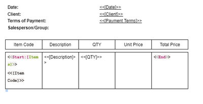

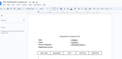

I already referenced the child table,
And this is now what's in my template,
But why is this not working?

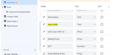

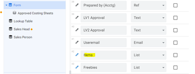

Can you please:
- share a screenshot of your table Form
- share a screenshot of your table Add Items

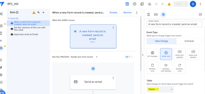

- make sure the bot is running against the table Form
- share a screenshot of your bot components (Event + Process + Step)
