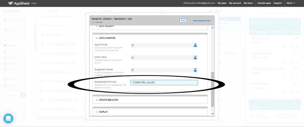

However, in the โAuto Computeโ field of the column, on the โSpreadsheet formulaโ line it generates this " โCOMPUTED_VALUEโ " text. And when I add data through the App, in the spreadsheet it actually fills in the cell with the actual words โCOMPUTED_VALUEโโฆand obviously, thatโs not good as it interrupts the ArrayFormula.

I have replied to Sorinโs bug directly. For the sake of the community, here is what I learned when investigating this issue.
This is a Google Sheets to Excel export issue.
When you click the โRegenerateโ button for a Google Sheets workbook, this is what happens:
When you add a new row through your AppSheet application, we convert the formula in the โSpreadsheet formulaโ property from R1C1 to A1 format and store that formula in the appropriate cell of the newly added row.
The problem is occurring because Google Sheets is exporting the formulas in columns J through N of your Google Sheet as:
โ__xludf.DUMMYFUNCTION(โ"โCOMPUTED_VALUEโ"")"
Typically, Google Sheets exports formulas that are supported in Google Sheet but not Excel by wrapping the formula in:
โ__xludf.DUMMYFUNCTION( )โ.
We extract the value contained inside the __xludf.DUMMYFUNCTION( ) and use that as the worksheet formula.
Unfortunately, in your case, Google Sheets is exporting your formulas in columns J through N as โCOMPUTED_VALUEโ.
As a result, that is the value we see and that we assign to the worksheet formula.
Fixing this problem would require that Google export your Google Sheets formulas in a better form.
You can report this problem to Google, but I am not sure how responsive they will be.
The other alternative is to change the formulas until you find a form of the worksheet formulas that Google Sheets will export to Excel correctly.
