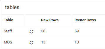

Ok, I got an automation to work (needing multiple actions, etc), but I needed to create a dummy table which shows me a comparison count between the raw data (table 1) and the merged data (table 2).
This all feels unnecessary if a Table could simply support a table wide (non-row level) action.
