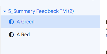

i created 2 format rules for 1 column
the problem is, i think my formula checks only the first row, and then applied  the format to all row below like in this screenshot
i want each row to have its own condition to check itself with the target number, if below target then green, if more than target then red, did i miss something in the formula or the options ?

can you send a screenshot of the color you selected for both format rules?
@Landan_QREW , here's the green one
and here is the red one
So weird. What happens if you disable one of them?
sorry for the late reply @Landan_QREW ,
here i disabled the green rules, so the 3rd row must be red colored, the result is nothing is colored red / green
still disabling green and enabled red, i the first row condition is met for red color, here's what happen, all the row is red colored where the 2nd row must be green / not affected to be red colored

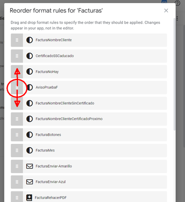

Formatting rules are applied in a certain order.
Check the order by clicking on the icon.
